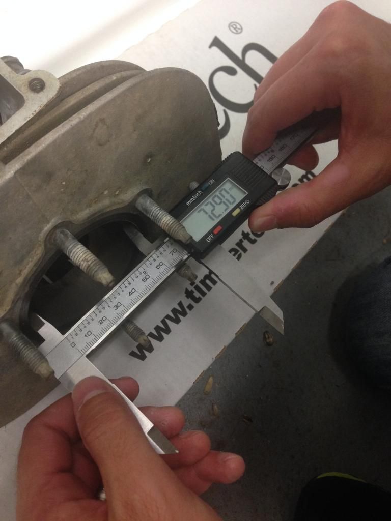

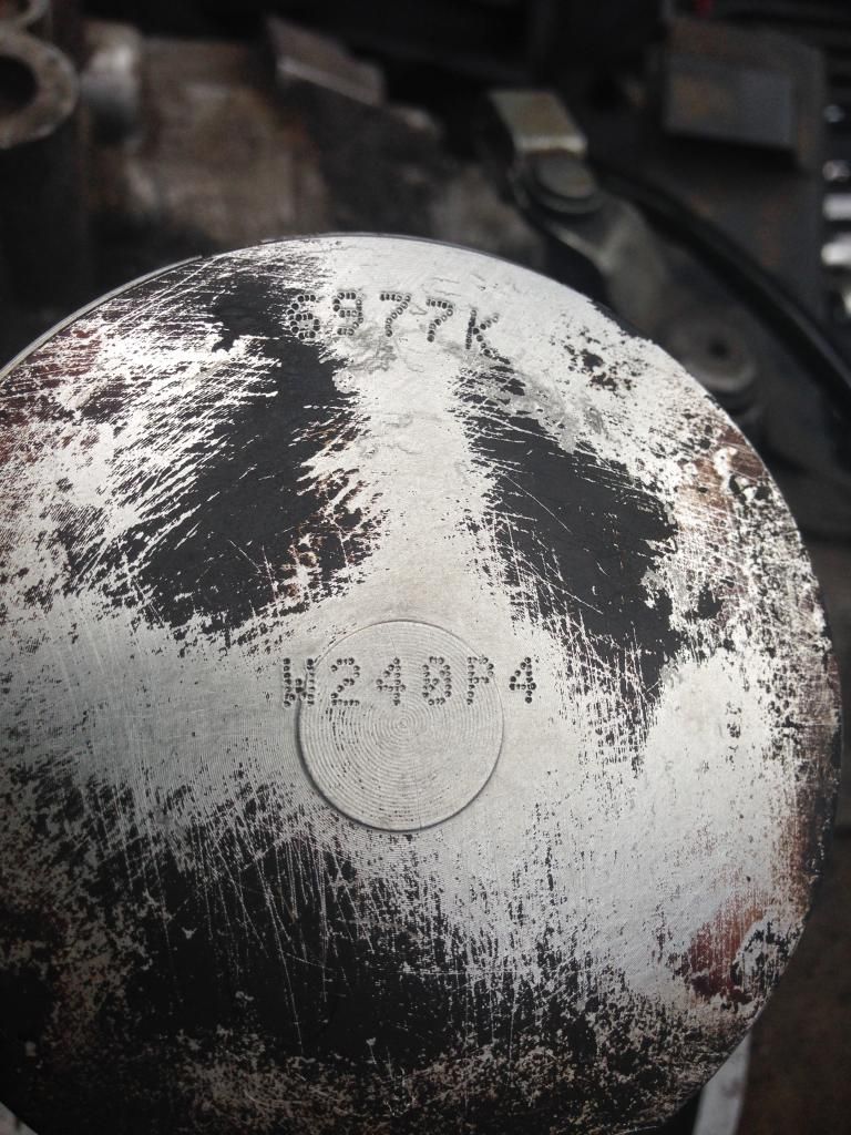

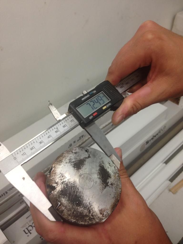

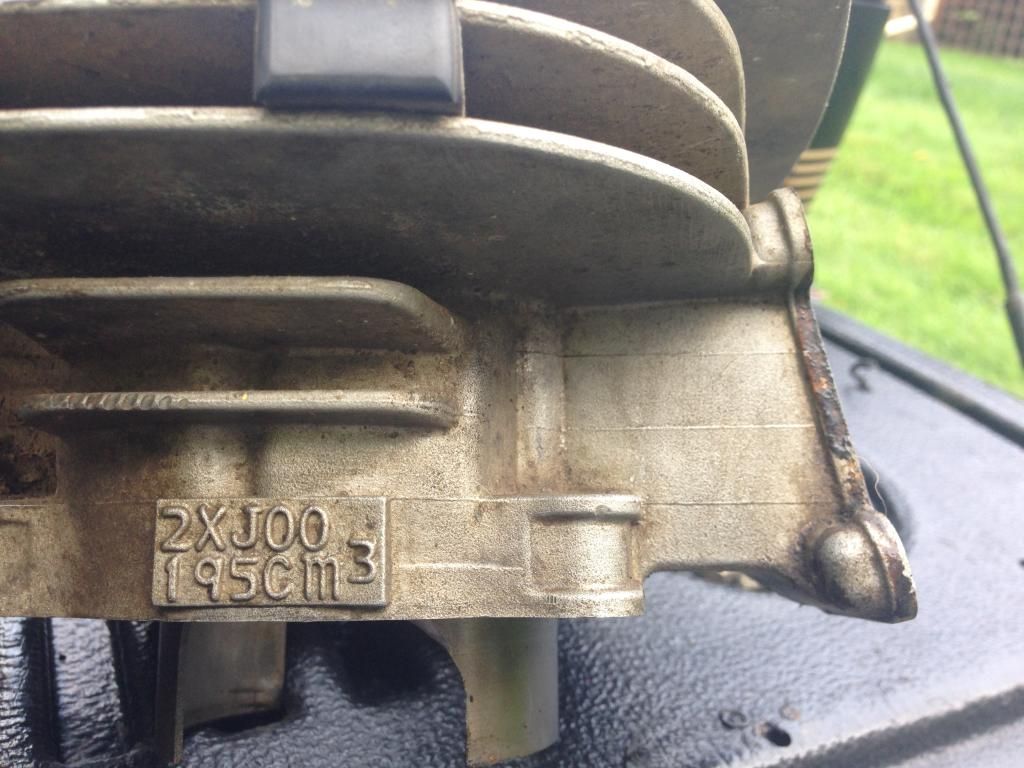

Bought a project for cheap, found out it has a vitos 240 kit that needs rebuild, no problem! Well I got to measure the bore and get 72.90mm, with the max bore being 73mm. My question is do I try to bore/hone it 1 last time to the 73mm and buy new piston and +3 stroker, or do I find a new cylinder that has some bore life left in it and ditch the stroker. HELP!!!
