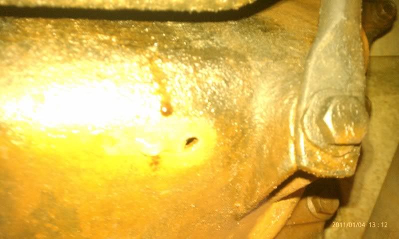

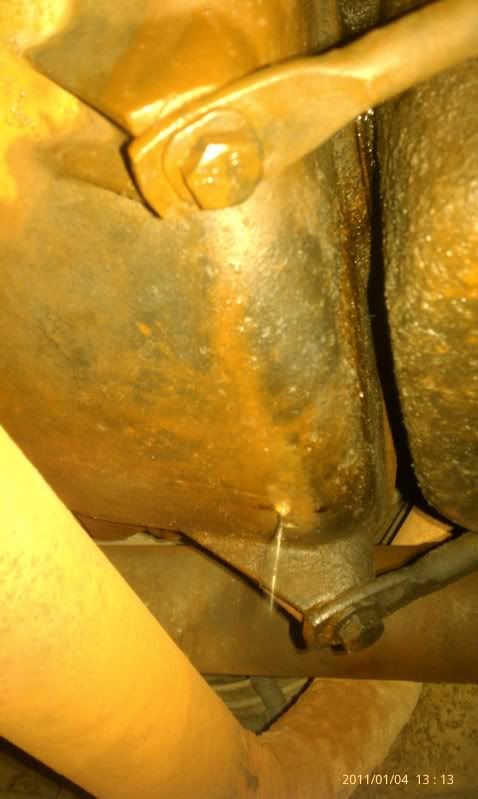

Ok I own a 93 Chevy z71 with the old 5.7 tbi 4 bolt main 350. I was driving it the other day and it started gushing water out the back end. Where the transmission attaches to the motor. There is a weep hole in the transmission bell housing like it was put there for this prob.
I suspect a freeze plug let loose. I have been all through my chilton's book and can't find anything on freeze plug locations. Have any of yall seen this prob before. I am tryin to fig out what it is before I pull it apart.

Yeah I think I've come to that conclusion also. It just sux cause it is a 4x4and I have to remove the front drive shaft and transfer case. So much for a quick fix.
