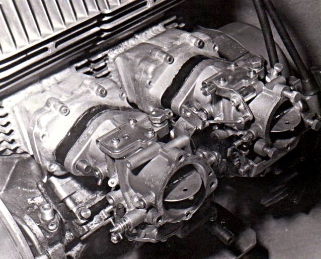

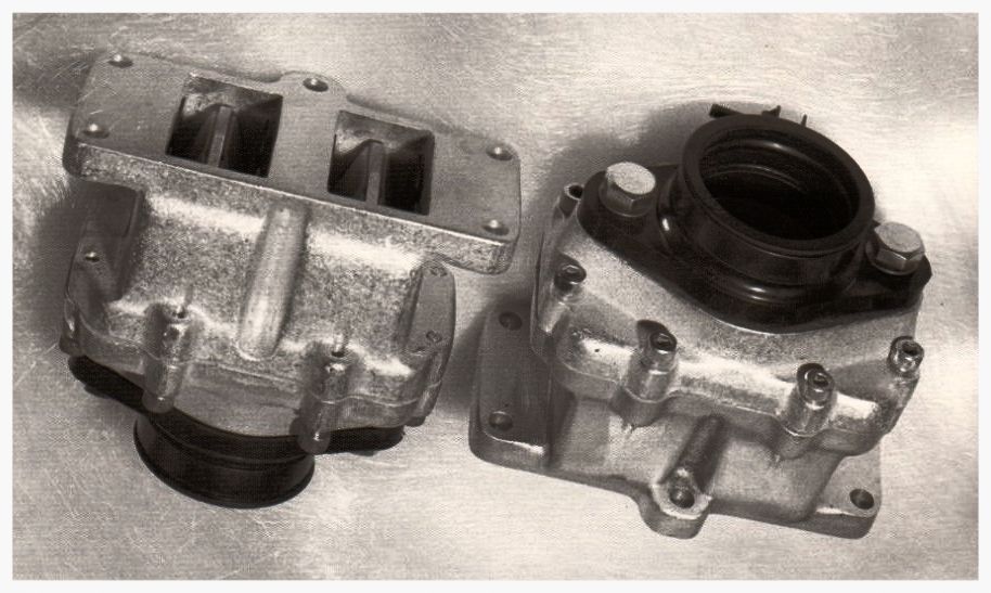

A DH type of boost port jig has been working for me for many years. Most of you folks are too young to know about Dale Herbrandson Reed Valves.
400 CZ DH reed
Reed conversion with rear boost ports.
