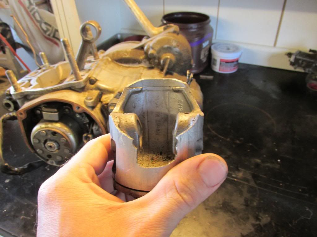

The carnage! Cylinder only suffered a small gouge

Split the cases
So i tore the motor down and split the cases.
To my surprise I found new clutch plates and springs, and the tranny is all clean and smooth shifting.
Main bearings were pretty sloppy intact.
Big end rod bearing appears good, but I'm not sure I trust it.
Compare the jug filth to the cases.... the cases looked way worse.
Not too bad looking
Split open and laid out
