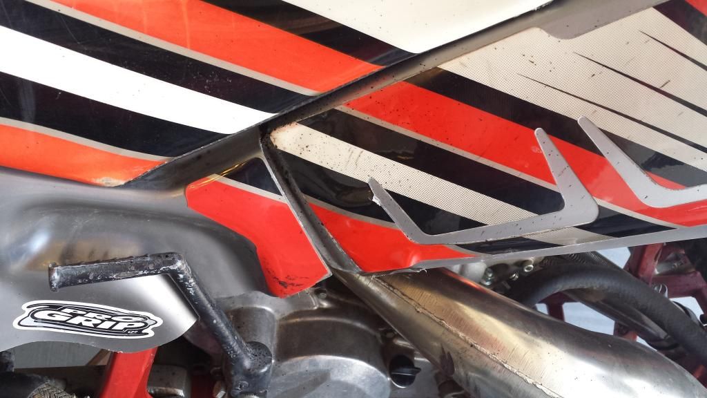

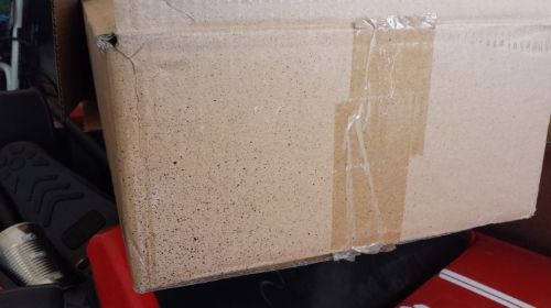

Its got an ESR310 kit, stock carb, fmf fatty/silencer. I have the 38 AS carb for it but annoyingly broke the idle screw..Ive read the stock carb will work with the 310 with a slight loss of power which is fine for now..Now here is the problem, it'll start on the 3-4 kick but needs 1/2 throttle to stay on. Anything past half throttle raises the revs slightly but nowhere near top of the rev band (although it did rev that high on one occasion...) and it does smoke ALOT. Altitude is 3900', 185 main jet, needle is on the 3rd clip from the top, not sure about the pilot jet...where exactly is the pilot jet located? I did open up the carb and cleaned it thoroughly before installing it. Any help would be appreciated!
Here is a picture of the black soot
A box behind the silencer
